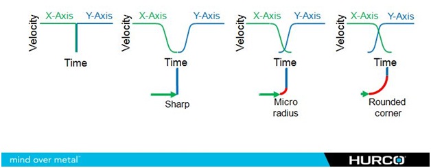

Motion Control 3
Although there are many types of parts that can benefit from UltiMotion, some parts will enjoy more of the benefits than others. Parts with contours consisting of many directional changes in the toolpath, parts with lots of holes, and any cutter toolpath with higher feedrates are perfect candidates for UltiMotion. A program with increased feedrates on complex contours is a perfect scenario where the variable block lookahead can really shine and make a huge difference in machine performance and in cycle time reductions.
When drilling holes, UltiMotion blends the sharp corners created at the end of each of the moves between holes, which allows for much faster transitions between the points. This spherical motion means that the linear axis will begin moving before the Z-axis has fully reached its commanded point, effectively rounding (or blending) the corner and eliminating the traditional pause in motion usually created when changing directions. Tapping retracts can be programmed up to 10 times that of the programmed tapping feedrates.
