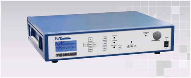

By introducing a controlled oscillation of the tool tip, Modulation Assisted Machining (MAM) has been successfully integrated into machining processes of all types and is particularly helpful when cutting or drilling some of the more difficult-to-machine materials that are found in many of today’s ultra-precision, high-performance components. This modulation is administered by the use of electronic frequencies and controlled by a separate stand-alone device that connects directly to the tool body itself.

The stand-alone unit provides the operator a method of precisely controlling the chip in a way that ensures every chip is consistent in both shape and size and eliminates the long, stringy chips produced by the traditional drilling process. These resulting smaller chips can flow very easily out of even the smallest and deepest of drilled holes and will resist binding in the hole during the process, which could easily break the drill.
