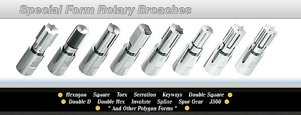

Rotary broaching is a manufacturing method that allows one to create both internal and external shapes on the end of a round workpiece very quickly with simple tooling and in the same machine setup as our other machining operations, which eliminates the need for additional setups and costly dedicated broaching machines. This not only makes it fast and efficient, but also makes the process more accurate and controllable than the older technology.
 ![Rotary Broach Tools](https://blog.hurco.com/hs-fs/file-22990002-jpg/images/rotary_broaching_2.jpg?width=600&height=229&name=rotary_broaching_2.jpg)
Although rotary broaching has been around for decades, very few people know much about this mystical machining practice. Because the entire premise of drilling a square hole is so foreign to many of us, even after you see it with your own eyes you still might not believe it. However, once you get your mind wrapped around the simple science of it all, you can see that it really isn’t magic. It is one of those manufacturing wonders that can really make a difference. Although I must say, when I see something like this, I have to ask myself, “Who the heck thought of that?!?!”
