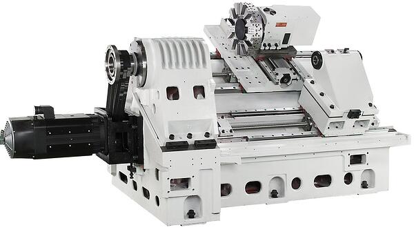

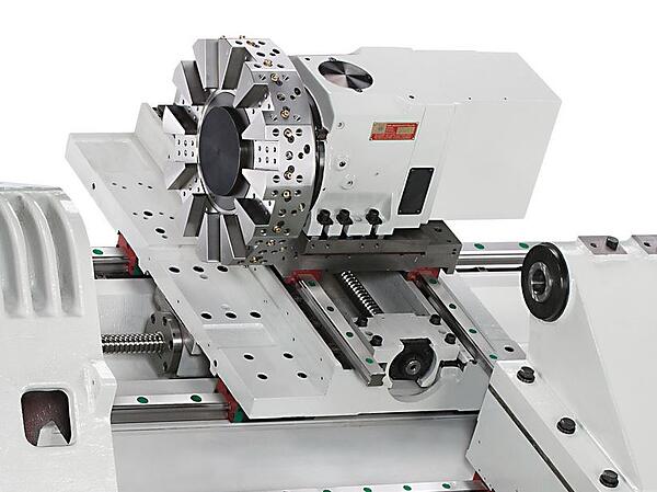

Unlike the flatbed “flying wedge” design, where the slant is achieved by the addition of a bolt-on wedge that is mounted on the cross slide, the true slant bed machine casting is manufactured with the slant built in. This not only offers more rigidity and thermal stability, but also provides the casting more overall mass. This means you have a much heavier machine with a smaller footprint. Typically, the true slant bed design is offered in one of two slant angles: 30 degrees and 45 degrees. However, there are also some 60-degree models available.

Another advantage to the true slant design is larger X-axis travels. Unlike the flatbed lathes, where guide rail length is limited to the horizontal depth of the casting, the true slant bed design allows for longer X-axis rails. Just like in a square box, the straight sides of the box are one specific length, but the angular distance from one corner to the other is much longer. The same is true for the slant bed casting design, which obviously means a larger part capacity in a smaller machine footprint. Although the “flying wedge” design, with the bolt-on slant, can also offer some increased X-axis travels over traditional flatbed machines, it can also magnify the lack of rigidity that is present in the bolt-on approach. You just cannot substitute for a sturdy casting design.

Thermal dynamics are also a big consideration in any machining process. The angular configuration of the base casting and extended X-axis guideways offer better rigidity and part accuracies. Since the linear rails are longer, the base saddle casting that carries the turret can also be longer, providing a much sturdier base of support for the turret. As the machine components begin to heat up during the machining process, the headstock, tailstock and cross slide will all begin to grow along the same 30-, 45-, or 60-degree plane as the X-axis. This differs from the flatbed “flying wedge” design, where the X-axis is mounted on a slant, but the rest of the machine components are mounted on the horizontal flatbed plane.
