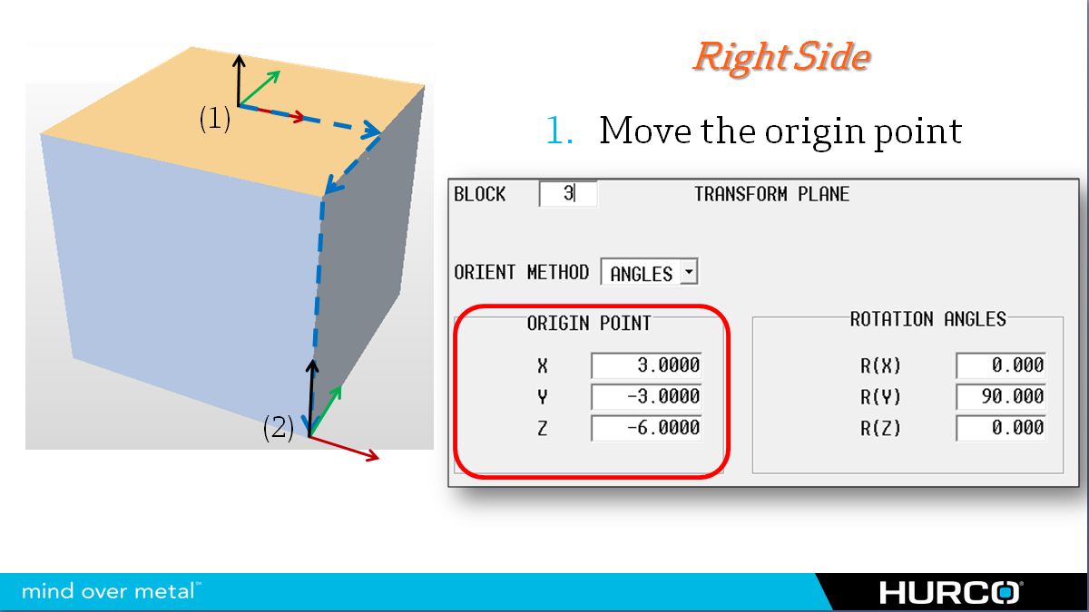

Once the parts have all been loaded onto the fixture, the first thing we need to do is relocate the origin point from the previous reference point located on the single part to the new location that we will use for this new process. Because we are running multiple parts on a round fixture, the most obvious place to reference for machining would be the top center of the fixture itself. Because we don't want to re-program the part, we will account for this position variation with a transform plane block.
A transform plane is typically used to re-orient and locate a temporary change in workplane, but here we will use it to temporarily relocate and orient an entire part program. Because transform planes can be stacked – meaning that if not canceled, a new transform plane will be an incremental change from the previous transform plane – we will keep this first one active until the end of the program, and the entire process is complete. Then we will cancel it.
In this example, the first part on the fixture (at the 3 o'clock position) is located 3.845" in the positive direction along the X-axis from the center of the fixture, and 1.393" positive in the Z-axis (reference image above). Therefore, we will enter these values into the XYZ fields for the "origin point" of the transform plane.
Now that we have relocated the entire program into position, we must tilt it 20° around the Y-axis to align it with the fixture. To accomplish this, we will enter a positive 20 into the "rotation angle" field for rotation around the Y-axis. The example below is showing a conversational program block, but the same thing could be accomplished in NC with the code: G68.2 X3.845 Y0 Z1.393 B20. The G68.2 designates a transform plane, the XYZ are used to relocate the reference point, and tilting around the Y-axis is a B-axis change.
Now that the first piece has been tilted and relocated, we must now address the other three parts on the fixture. We will do this by "looping" the previous step, and execute the part program again at the remaining 90° intervals. This step will be accomplished with a "transform plane group" command. The transform plane group allows us to pattern a transform plane in any direction, and in this case, rotate (or loop) it four times, around the center point of the fixture, in the Z-axis, every 90°.
