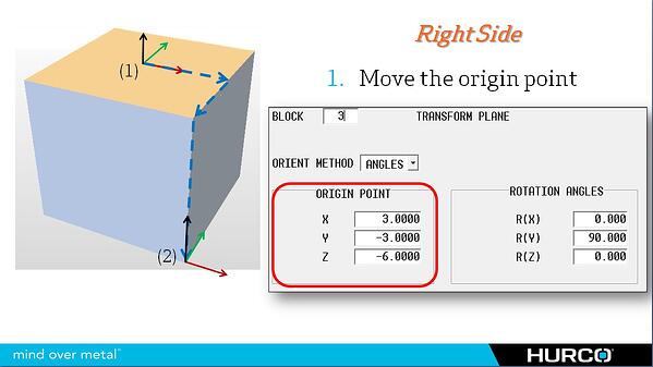

First, we need to move the origin point. Using a conversational block called Transform Plane, we will provide the control a roadmap of directions from the original workpiece zero to the newly desired origin point for the new workplane.

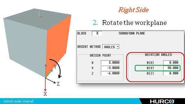

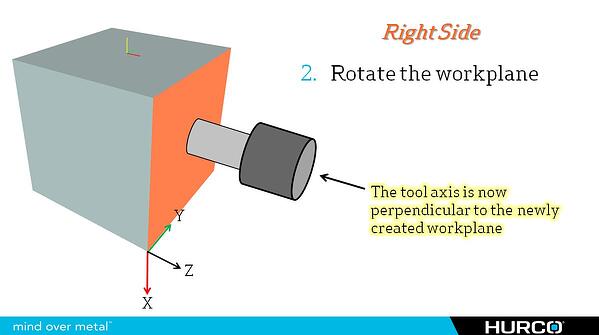

Next, we need to tilt the workplane to create a tool axis that is perpendicular to the desired face of the part. When programming this step, we will simply program the tool moving around the part. We don’t care what the actual machine configuration is. In this example we will rotate 90 degrees around the Y-axis (B-axis move) even though the machine may not have a B-axis, the control will figure out how to position the axis it has available to achieve the tool orientation we have programmed.

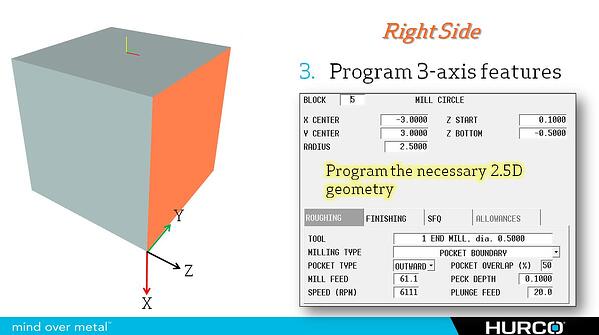

With the origin point successfully relocated and the workplane tilted into position, we can now program our simple 2.5D or 3D features as directed by the part print.

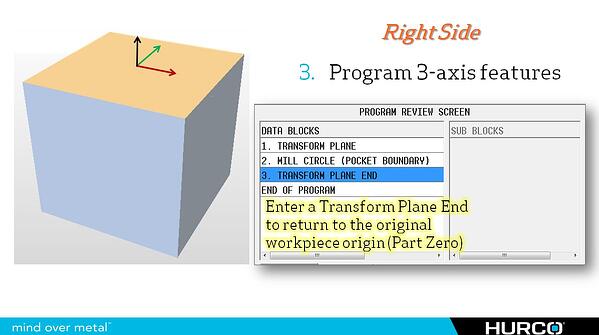

Finally, we need to cancel the current “Transform Plane” to revert everything back to the original part setup location. We will now repeat these steps until all sides of the part have been successfully programmed.
