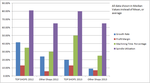

The survey asks numerous questions about business performance. Please note: the charts illustrate Median values instead of Mean (average) values to give a clearer representation of the data. To see the data as averages, access the TOP SHOPS ZONE at the Modern Machine Shop website.
Growth Rate
The growth rate is defined as the current year’s sales minus the previous year’s sales, divided by the previous year’s sales multiplied by 100. Therefore, the formula for the Growth Rate in the 2013 TOP SHOPS Report is (gross sales 2012 – gross sales 2011/gross sales 2011 x 100).
Therefore, it’s important to note that the 2012 growth rates are much higher because the formula is comparing growth from 2010, a recession year, to 2011.
- TOP SHOPS 2013 = 20%
- Other Shops 2013= 9%
Profit Margin
The profit margin is reported as net income divided by gross sales x 100.
- TOP SHOPS 2013 = 13%
- Other Shops 2013= 7.0%
What I think is most interesting about this data is the fact that the profit margin has stayed relatively the same for Top Shops (12.9% and 13%) whereas Other Shops have increased their profit margin from 5.9% in 2012 to 7% in the 2013 report, which is essentially an 18% increase.
Machining Time Percentage
Machining Time Percentage is calculated by dividing the amount of time that the part is being machined by the order lead time. Ultimately, a higher percentage denotes efficiencies in the work flow of each job.
- TOP SHOPS = 50%
- Other Shops =25%
Spindle Utilization
Spindle Utilization Time is the in-cut time as a percentage of machine up time.
- TOP SHOPS = 80%
- Other Shops = 65%

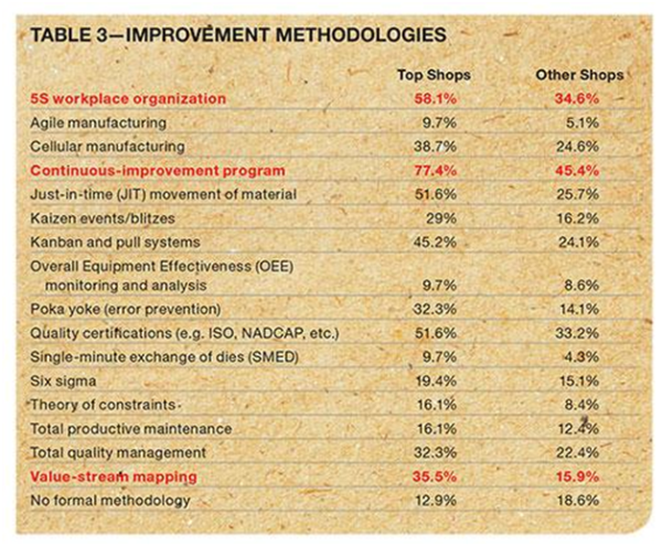

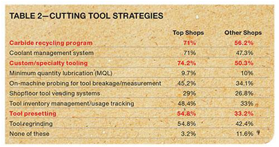

After reviewing the data from this report, I think there are four things that set TOP SHOPS apart from the Other Shops: greater investment in machine tool technologies and cutting tool strategies (see Table -2 from the TOP SHOPS Report), a commitment to Improvement Methodologies (see Table – 3 from the TOP SHOPS Report), and a commitment to Human Resources programs that reward engaged and motivated employees.
(Images courtesy of Gardner Media)
Modern Machine Shop has a great article about applying improvement methodologies in a high-mix/low-volume environment “From Job Shop Chaos to Lean Order.” The article explains how a job shop clustered certain machines together by grouping parts that share similar routings into potential process families.

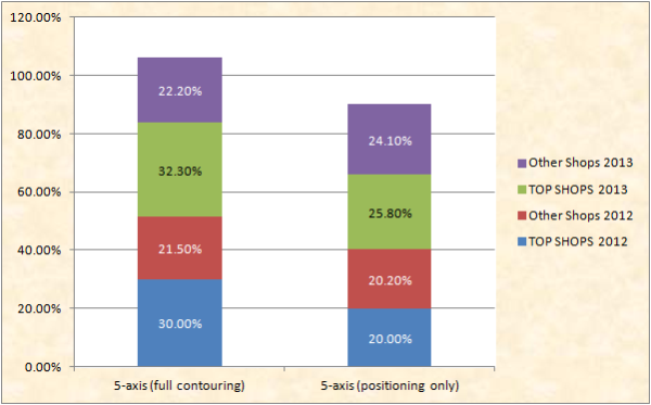

5-Axis
At Hurco, we’ve focused an enormous amount of our resources on 5-axis technologies because we think it’s the most expedient way for shops to increase profitability—especially in the “high mix/small batch” world in which many of our customers operate. The idea is to significantly decrease setup time by using 5-sided (or positioning only) on existing parts with the opportunity to bid on higher margin Simultaneous 5-Axis (or full contouring) jobs when you’re ready. From this year’s Top Shops report, it appears all shops are increasing their investment in 5-axis machining centers, but TOP SHOPS continue to have a higher percentage of these machines and continue to grow the Full Contouring 5-Axis part of their business.
5-axis (positioning only)
- TOP SHOPS = 25.5%
- Other Shops = 24.1%
5-axis (full contouring)
- TOP SHOPS = 32.3%
- Other Shops = 22.2%
If you still haven’t made the leap to 5-axis, check out FiveAxisMachining.com, an educational website sponsored by Hurco that has lots of resources to get your started. One of the most popular resources is the interactive worksheet that lets you easily evaluate whether you can increase your profit margin on existing parts by switching from 3-axis to 5-axis positioning (or 5-sided machining).

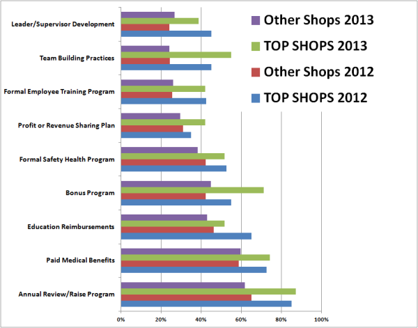

Human Resources

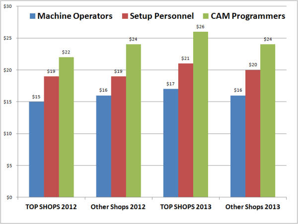

In addition to higher investment in machine tool technology, cutting tool strategies, and continual improvement programs, Top Shops invest in their employees. The hourly wage Top Shops pay their manufacturing personnel is about the same as other shops, but Top Shops invest in programs that focus on personal growth (Leadership Development, Annual Review/Raise Program, Bonus Plan, Formal Training Program, Teaming/Team Building).
