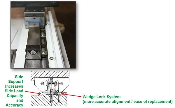

In addition to the solid base casting, high-quality and larger than average linear guides – as well as the manner in which these rails are located and mounted – also help to provide the necessary solid foundation needed for heavy machining, and aid in the enhanced performance of the Hurco machine. The larger size and quality construction of these carefully selected roller ways help to reduce friction - which allows for faster and smoother machine accelerations - and, in turn, this reduced friction allows for increased accuracies. Hurco locates their roller guides against a solid ledge, machined into the base casting itself, and secures them in place with closely spaced wedge-style clamps – that are designed to increase both the linear forces against the machined ledge, as well as providing increased downward forces to keep the rails secure during machining. This design provides an exceptionally accurate alignment of the components, while still providing for the ease of replacement - in the event the unspeakable happens!
Wedgelock
