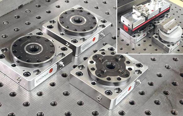

To understand and begin this migration toward automation, you first must understand and buy in to the ideas of standardization and palletization. Winning in the game of high-mix, low-volume part manufacturing means reducing spindle downtime. The first step towards winning that battle is standardizing your setup process. At the end of the day, you can only invoice for the parts that you have completed. So, reducing idle time between jobs is a crucial step to getting more done in a typical eight-hour shift.

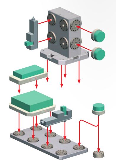

Palletizing and standardizing your setups can be done in a variety of ways, such as:
  • installing a sub-plate on the machine table that has labeled rows and columns of locating holes for quick and accurate placement of workholding
  • adding a quick-change pallet receiver system
  • standardizing material sizes and part-zero locations that are utilized for every part.
    These are all examples of how this next crucial strep can be accomplished. Whatever idea you come up with to make it quicker and easier to switch from job A to job B with as little downtime as possible is the correct answer to this question.
Automation_1
Now, once you have completed the first steps of standardizing and palletizing your setup, then you can begin to think about the next step: automating the process. This could be as simple as hand-loaded pallets that the operator switches out manually, or it could be as complex as a robot that automatically switches the pallets in a lights-out or hands-off approach. The pallets could be loaded with the same part over and over again in a large-quantity order scenario. Or because you have now standardized on material size and the part setup location of each job, these pallets could also be loaded with several different parts for the smaller-order quantities that exist in a high-mix, low-volume environment. Either way, you are beginning to make the process of changeover work for you, and not against you.

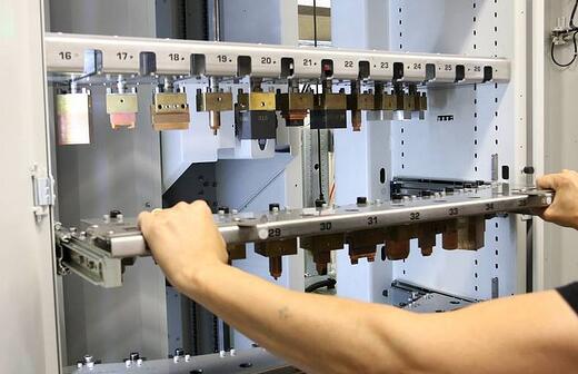

At the International Manufacturing Technology Show 2014, Hurco partnered with Erowa to demonstrate the benefits of automation to our customers. We installed an Erowa Compact Robot alongside one of our 5-axis machines at the show and used the opportunity to demonstrate loading and unloading several different parts in a high-mix, low-volume scenario — a scenario that many of our customers find themselves in. The feedback that we received was overwhelming, and many of these shops could envision themselves utilizing this technology in a lights-out process that would allow them to run parts unattended throughout a weekend or during a third shift when the machines would normally be sitting idle.
Automation_4

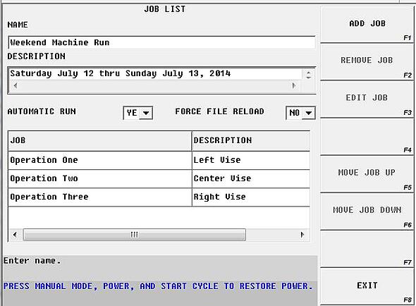

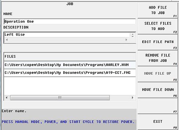

When automating the manufacturing process, whether you are loading pallets or jobs manually or automatically in a lights-out scenario, you will need to have a way to seamlessly move from one program to the next, as well as a way to prioritize and schedule when a particular program will run. The way Hurco has addressed this issue is with a control feature called JobList.
Job_List_1
Job_List_2
The JobList function in Hurco's WinMax control allows an operator to group part programs together by specific projects (or jobs), and then prioritize and schedule when those jobs will be executed on the machine. For example: an operator can load up a series of jobs into vises on the table or onto individual pallets in a robot, and then execute a JobList that will run over the weekend unattended.
