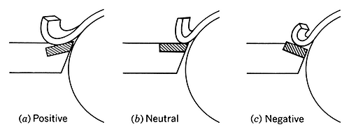

This is especially true when using carbide cutting tools. Increasing the speed will ensure that the material is in contact with the tool tip for a shorter period of time, reducing the edge buildup on the tool, which can cause poor surface finishes. Increasing the rake angle of the cutting tool will also help to reduce and control edge buildup.

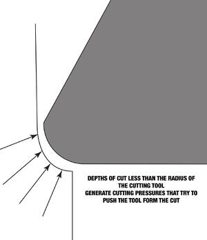

### **3. Use the Correct Tool Nose Radius**

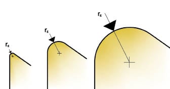

A larger tool nose radius (TNR) will be able to accommodate faster speeds. Inserts are capable of feeding at approximately one half the TNR per revolution and still produce good results. If this TNR-to-IPR ratio is exceeded, the tool will create more of a thread-like surface finish and not the shiny smooth finish that you desire. Therefore, the larger the TNR, the faster the feedrate it can accommodate and still produce the desired results. HOWEVER, using very large TNRs can produce chatter due to the increase in cutting pressures, so be careful and consider the speeds required for the materials that you are cutting. Use a tool with the TNR that fits your needs.
It is also worth mentioning that the use of a larger TNR will mean that you must leave more material for your finish pass. To ensure that the tool is behaving properly, you must leave **equal to or more than **the TNR for your finish tool to remove.

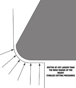

If you are experiencing chatter in the corners, then you might want to try a smaller TNR. Always use a TNR smaller than the corner radii that you are cutting so you are forming the necessary radius, especially on finish tools. This will help decrease cutting pressure and eliminate the chatter.
When milling, try a bullnose or ballnose endmill instead of a flat endmill. Something with a corner radius will give you a superior finish over a sharp corner and will definitely help increase your tool life.

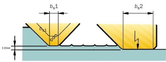

A wiper insert has a small, flat area that is adjacent to the TNR. This flat actually wipes the finish smooth as the tool feeds along the workpiece and will help eliminate the thread-like finish that can occur with faster feedrates, which allows the use of smaller TNRs to help control chatter.

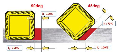

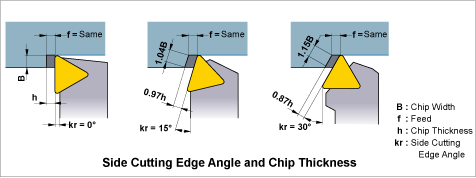

Higher lead angles and positive-raked inserts produce a better surface finish than tools with a shallower cutting angle. For example, a facemill with a 45° cutting angle will produce a better surface finish than one with a 90° cutting angle.
