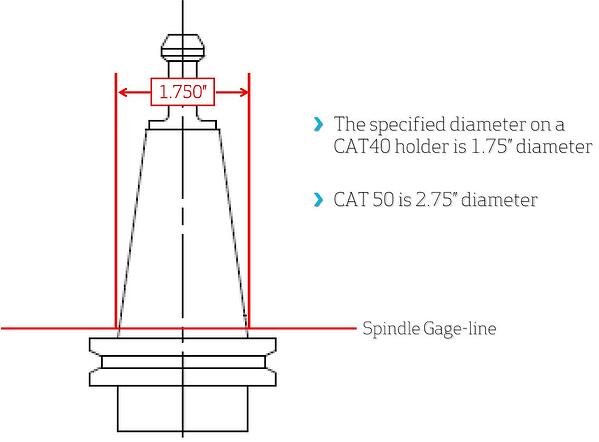

Spindle Gage Line

Contrary to popular belief, the spindle gage-line isn’t the spindle nose itself. It is actually a measured diameter that falls along the spindle or toolholder taper. For CAT 40 tooling, the magic diameter measurement is 1.750”; it's 2.750” for CAT 50 holders.
