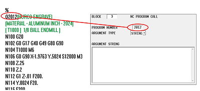

NC Merge is a conversational block inserted within a conversational program that is used to call an NC program whenever the need arises. This offers the machine operator the flexibility and versatility of programming the simple 2D geometry in the WinMax conversational program language, while still allowing them to take advantage of the strength and flexibility of conversational programming, but provides them the option of calling the NC program when necessary.

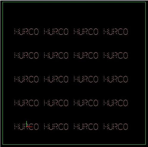

To add additional versatility and strength to this already powerful function, the WinMax control also offers the programmer the ability to combine the NC Merge option with conversational patterns: scale, mirror image, transform plane, loop linear, loop rotate, etc. Scaling NC features, or using mirror imaging for left & right part features, is a good example of this additional flexibility. NC Merge can also be used with “nested” patterns so you can both scale a feature and mirror image it in the same program as many times as necessary to complete a particular part.
