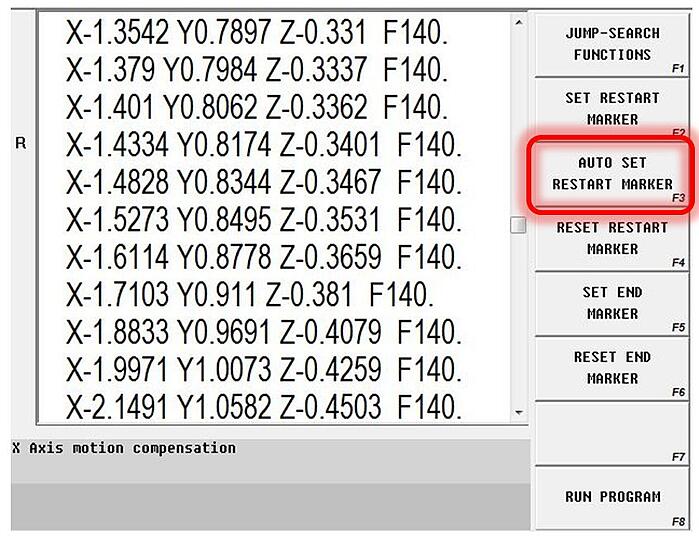

Starting with WinMax® version 9, the software will automatically insert a restart marker at the exact location of the last block executed before the interruption, which relieves the pressure on the operator to remember (or guess) what block to restart the program.

With the new feature, all we had to do was enter into the "Recovery Restart" screen and press the "AUTO SET RESTART MARKER" softkey. The marker (R) was automatically inserted into the correct position for restart, and we were ready to run. Then simply press "RUN PROGRAM" followed by the flashing "CYCLE START."
Auto Set Restart Marker 1
