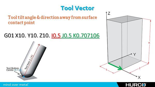

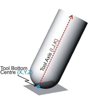

So, what is a tool vector? Tool vectors are simply IJK values in a program, added to the end of an XYZ position, that determine what angle and direction the tool should tilt away from the commanded XYZ position. For example: a tool vector command of G01 X10. Y10. Z10. I0.5 J0.5 K0.707106 would be the same tool and axis position as calling G01 X10. Y10. Z10. B45. C45 without having to call out specific axis commands. The second command could only be utilized on a machine with a BC machine configuration.

Although tool vector data points are not measured distances and have no unit of measure associated with them, this is how I see them in my mind when trying to visualize a commanded tilt angle of the tool. The three letters used in a vector correspond to the three axes of the machine; I falls along the X-axis, J along the Y-axis, and K is in the Z-axis direction. For visualization purposes only, in the example below let’s assume that each IJK token is a measurement in inches. From the XYZ tool contact point, assume a point in space that is .5” positive in the X-axis, .5” positive in the Y-axis and .70716” up in the positive Z direction. Now in your mind, picture a line that begins at the center of the tool tip and extends upward through the point in space that was created by the IJK tokens. That would be the commanded tilt angle and direction of the tool. It’s just that easy!
 Tool Vector 5-axis machining

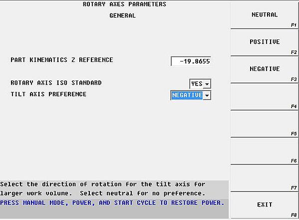

There is one last thing that we must discuss when talking about using tool vectors to program in 5-axis. When you allow the machine to determine how it is going to use its available rotary axes to position the tool to the commanded tilt angle, and we recognize that there are at least two acceptable solutions for every 5-axis combination. We have to determine a way to force the control to choose the one that best suits its individual machine configuration. We do this by applying something called “tilt axis preference” — a setting within the control parameters for each machine tool control capable of programming with tool vector input.
Tilt axis preference is used to force the solution of the current 5-axis command that is the best suited direction of rotation for the machine the program is being executed on. For example: on a trunnion machine, where the A-axis can tilt 110 degrees in the negative direction but only 30 degrees in the positive direction (like any of the Hurco 5-axis trunnion machines), we need to do what we can to “force” the control to always tilt negative when possible, ensuring that we have enough axis travel to complete the move.
Tilt Axis Preference 5-axis machining
